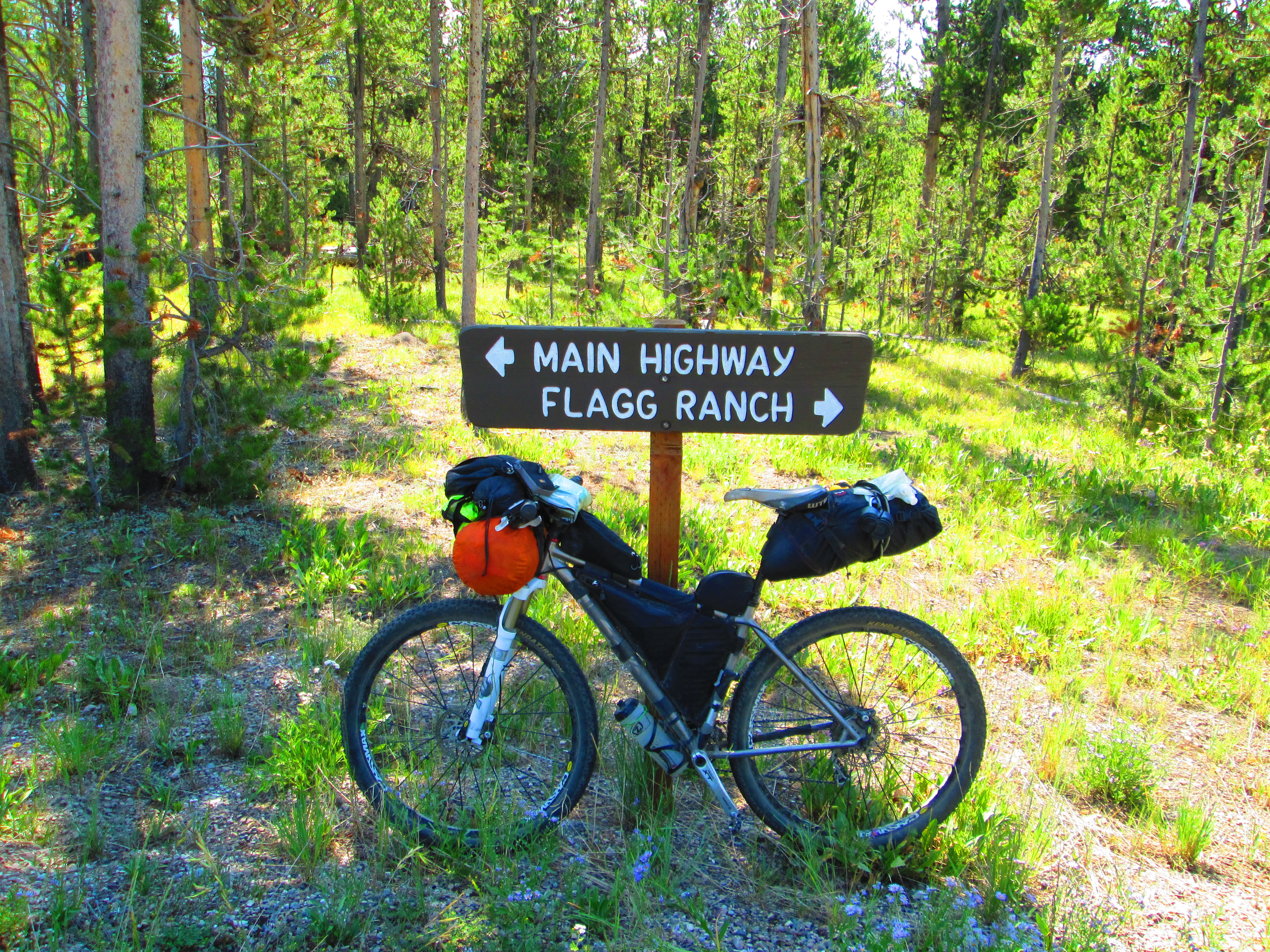

So this summer I was lucky enough to be riding the Great Divide Southbound, starting in Bnaff and finishing in Antelope Wells.
(Somewhere In NM, the only “Great Divide” sign I’ve seen… at that time of the ride everything was packed neatly)

I used Revelate Designs’ Bags – the Bigger version of the seat-post bag, the Viscacha, the Sling handlebar bag with a Large “Pocket” on top , the El Mariachi Frame bag, and both of the top tube bags.

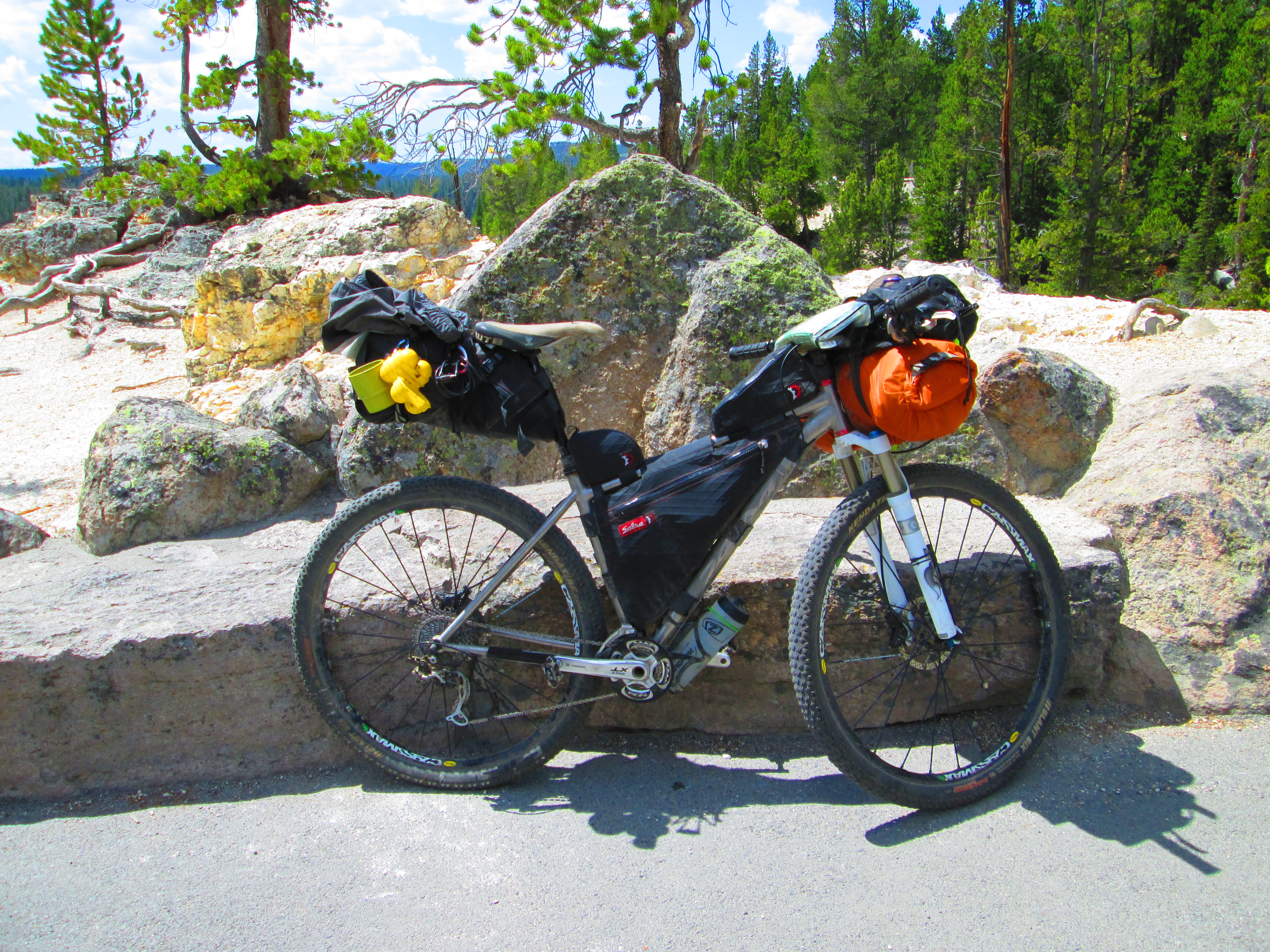

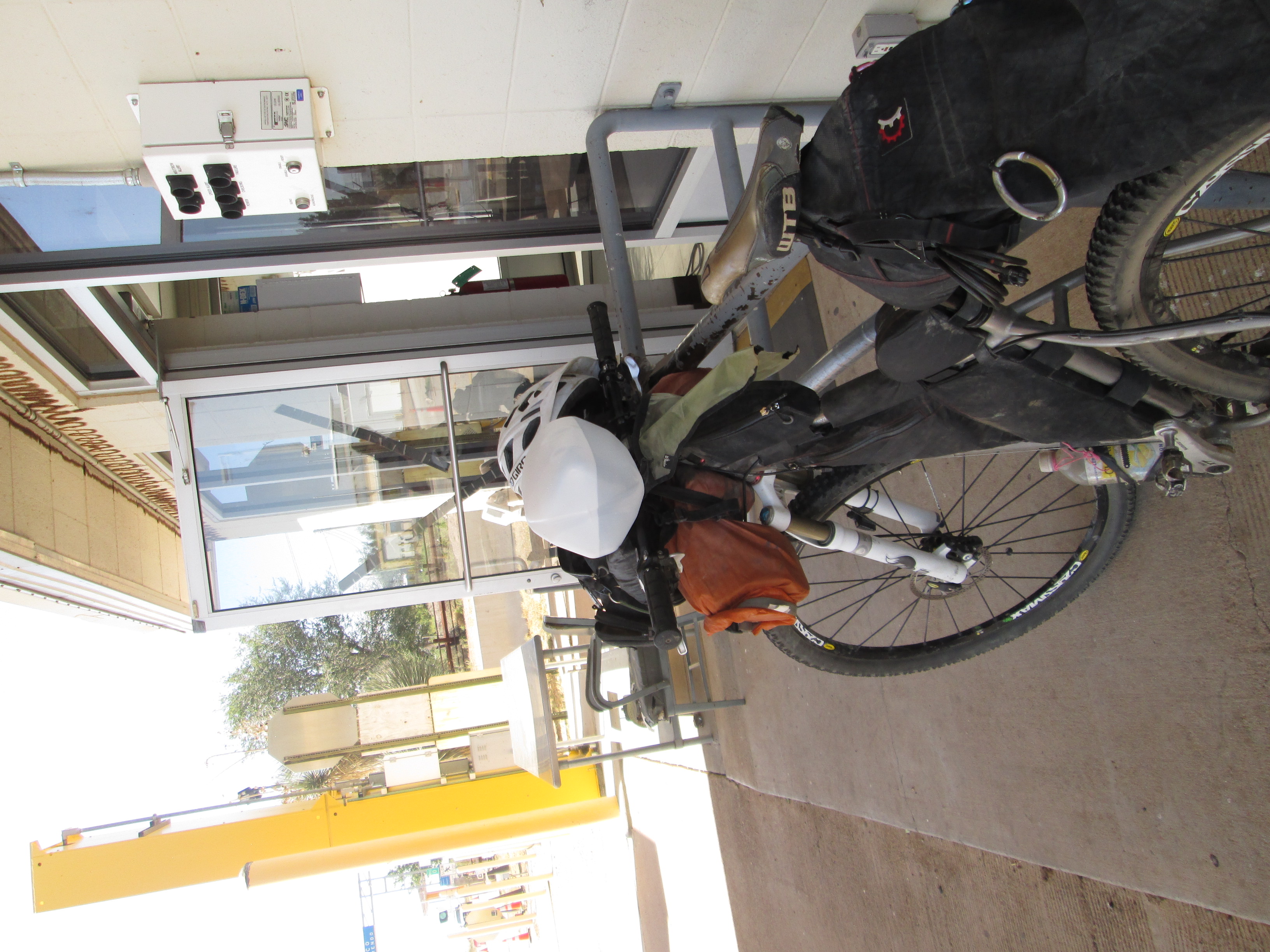

    In these sections, and some other I carried about 9-10 Liters of water. In order to be able to carry so much water, but be worry free in times when you don’t need so much water, It’s great to use water bladders. They’re collapsible so  they don’t take up much space, and when you do need them you can pack them in different places on your bike.When things got rough with water, I packed the 2 Platypus bladders on top of my Viscacha seat post bag, and packed my 3 liter water Bladder on the handlebar packing system, between the Sling\dry bag and the Pockets straps. I can’t say it was awesome, and eventually two days before the end my water bladder was destroyed after being rubbed at the tire, so I packed water like this :
(Couldn’t rotate the photo. anyhow, notice the huge 1-Gallon plastic container on my handlbar. Yes. I was riding like this for about a day and a half. Yes, the handling is even more awful than having full 3 liter bladder on the handle bar. I was lucky that it was mostly flat and paved, otherwise I could have been in some trouble)

(Taken at the Big Basin by some random jeep owner. Notice the blue water bladder hiding on the handlebar bag, the the bear spray on the Viscacha strap and the 2  emtpy Platypus bladders on top of the Viscacha)
