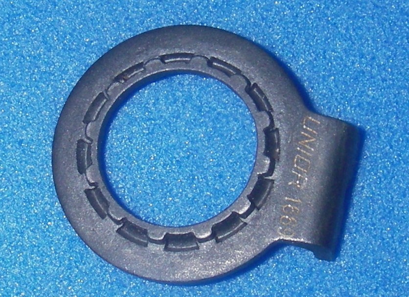

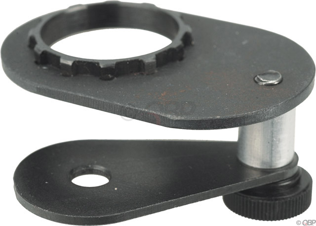

A cassette lockring tool is handy to have a long, I have had a cassette loosen up during a ride. Regular ones are heavy and require a heavy wrench to use.
Here are two that are tiny and do not use a wrench.
Unior Cassette tool
Unior Cassette toolStein cassette lockring tool
