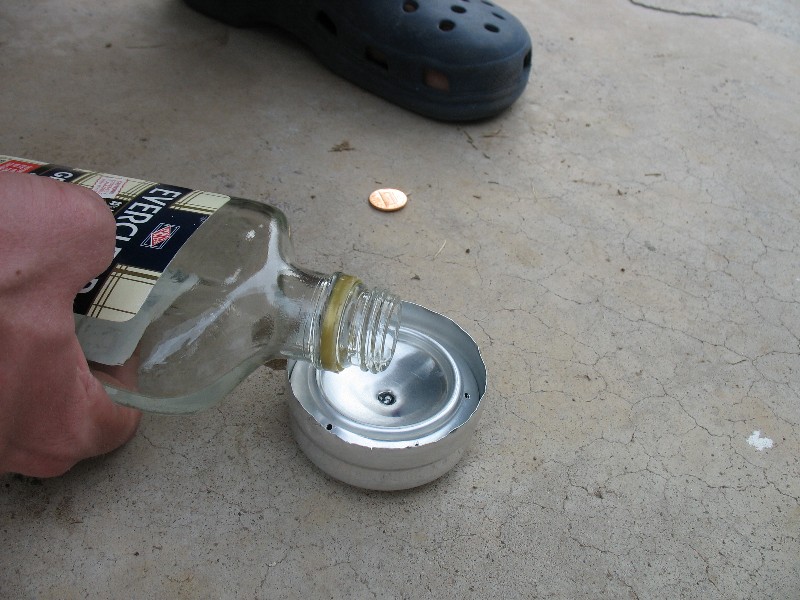

Ultralight and Durable. Sensing a need for a lightweight stove for a future of Arizona Trail tours, we built some Penny Stoves found at this link:http://www.csun.edu/%7Emjurey/penny.html.

So what´s the coin for ?
Re: glezher
The coin is the lid for the filling hole. Stops the fuel burning from the middle hole so it only comes out the jets.
