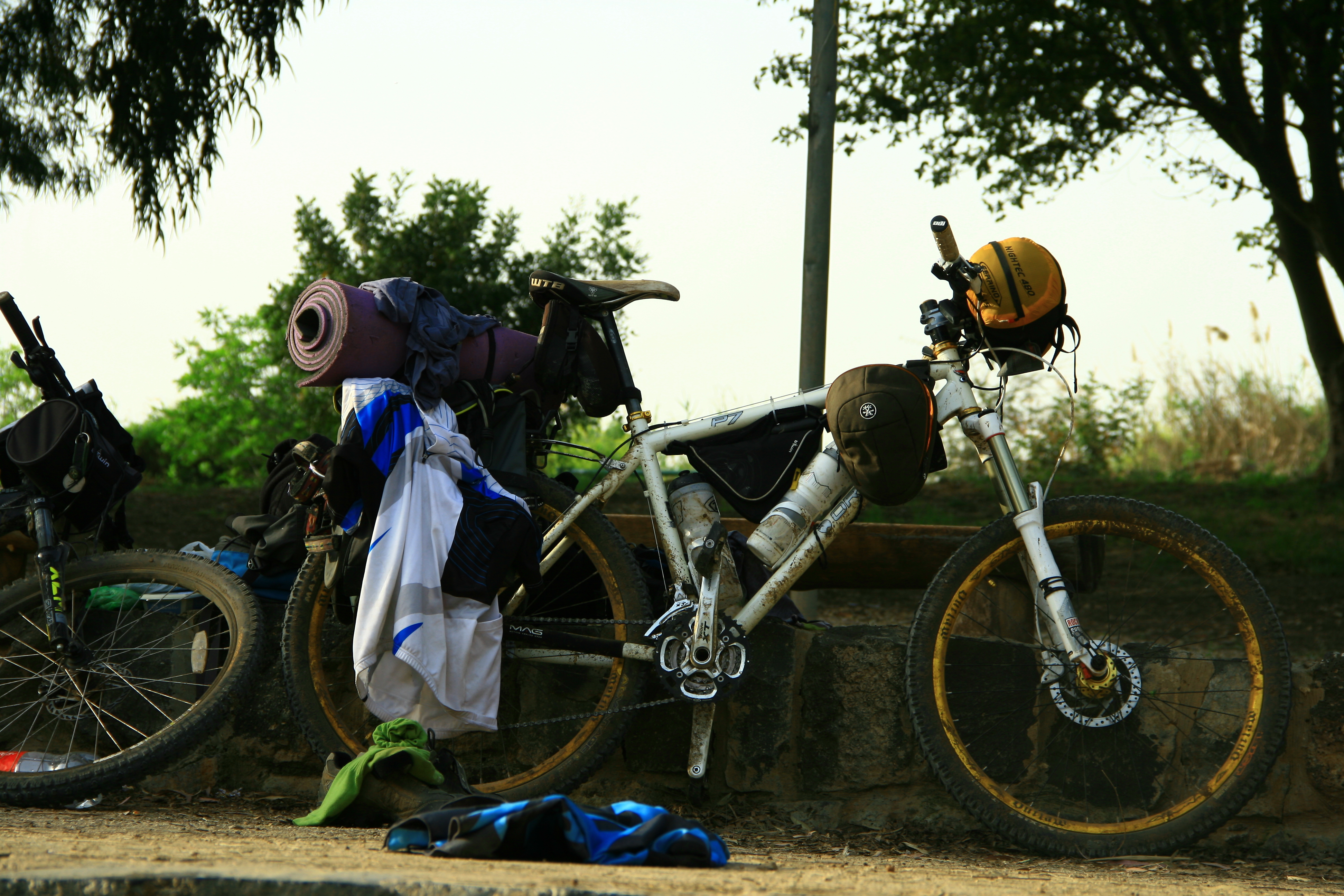

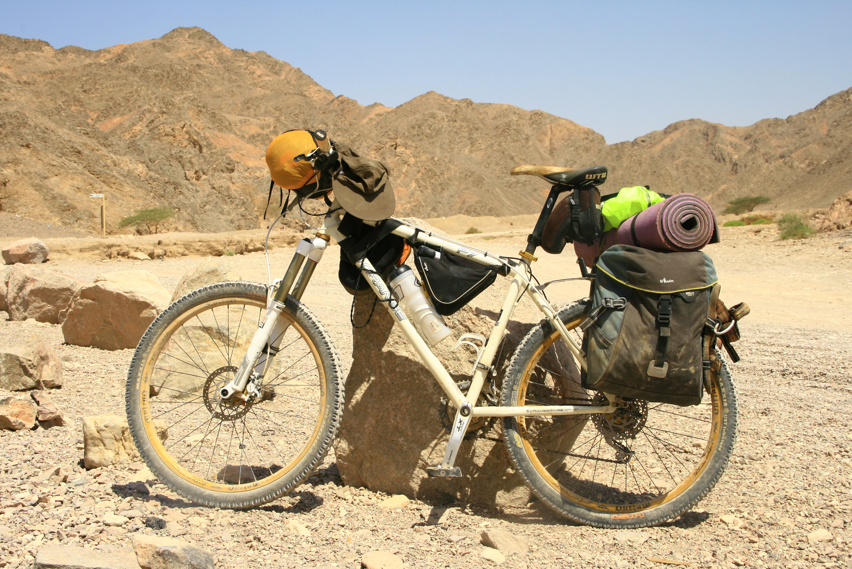

As you can see in the pictures, my carrying system was as follows:
two panniers on a rack – carrying most of the equipment
A frame bag which contained the mechanical spares, working tools and chain lube.
a Sleeping bag attached to the handlebar
A small seatpost bag for some accessible food – power bars and nuts.
DSLR Camera bag attached to the frame.
As I don’t like carrying a backpack while riding, I was taking along a small 11-liter backpack with a 3 Liter hydration pack, but most of the time it was inside the pannier.
I was carrying 2 Liters of water on the bike in hydrtion bottles. When needed, I was carrying on my back in my riding shirt’s backpockets some more water.

(the bike in one of the stops, assorted equipment all over the place)
