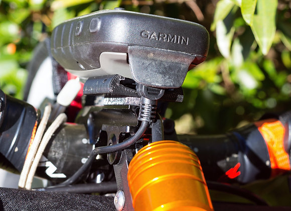

I'm using a K-Edge Wahoo Element Combo Mount with the Beacon attached below via KevinB's adapter.
The K-Lite mount mentioned by Marc40a is actually a K-Edge Go Big handlebar mount modified with a 3D printed Edge mount on top. If you already have one of these Kerry can supply just the printed mounts and hardware to attach it.

Yes, that is the one I have. Kerry sells it as a complete kit but I already had the K-Edge Go Big mount so Kerry (KLite) supplied only the 3D printed eTrex mounting plate.
Look closely at the second pic from the web site and you will see the K-Edge mount with the light attached to the GoPro mount via an adapter, and the 3D printed eTrex mounting plate sitting on top.
