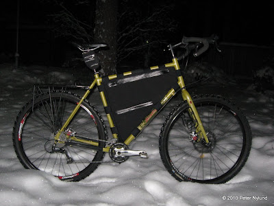

I finished mine tonight. This thread provided me with tips and inspiration, so I think it is only fair to post the result here:

Wow! Very nice. That frame looks like it has a ton of room in it.

Thanks. It is an XXL sized Fargo. I've had it only for a couple of weeks and am really looking forward to do some overnighters with it.
