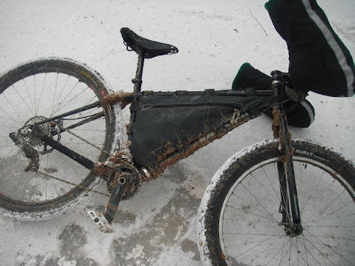

So, I made some pogies last winter, but would like to make a second pair soon, with some major refinements.
V1 worked well enough, but more could be done better.
Shell is Dyneema Gridstop (coated), then 2 layers of fleece, them a 1.1oz uncoated nylon liner (or maybe Momentum??)  2" wide flexible plastic stiffener down the top, 2 velcro straps internally to secure to bar ends, webbing to cinch around the bars.
Pattern is good, but could use a tiny bit more volume for easier shifter access - it is good now, but it depends on how straight the collar around the bars is.
So, some questions to the Pogie Experts on materials selection and other design considerations
Waterproof breathable shell?  Or just uncoated breathable?  WPB would be better for wet snow and block more wind
Removeable insulated liner?  Make a good WPB shell, with pockets, reflective strips, and maybe a vent zipper in the front then have velcro in liners with 1.1oz nylon shell with primaloft insulation (how thick?  0.6" or more?).  The vent zipper would only be in the WPB shell, and there would still be 2 layers 1.1oz nylon and insulation keeping the wind out, but it would help get condensation out of the shell when it is warmer.  The removable liner would also be easier to dry, although you would still have to remove the whole thing.  It would also allow you to add more insulation, or change the liner for a more or less insulated one depending on conditions.
What is the best way to make the wrist closure?  Maybe some elastic fleece or primaloft collar?

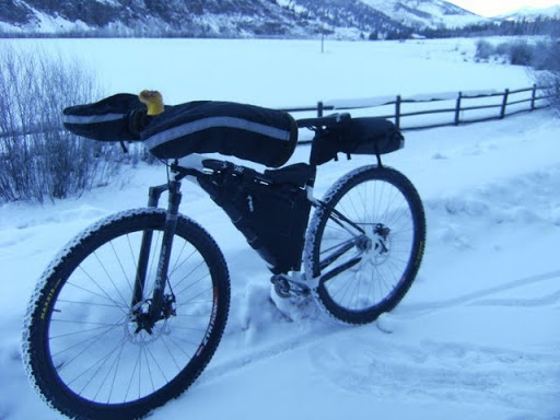

first one done.  200wt fleece inside (with non-zip pocket on bottom), 200g Thinsulate Ultra, Gore-Tex shell (a little thinner than I was hoping for, but ok), sides and top stripe over the cutting board stiffener is 1000 denier Cordura.  Zip pocket on bottom.  the wrist seal came out pretty ugly, but at that point, after breaking several needles and giving my Singer a hard workout, I was ready to be done.  I'll need to cook up a better order of operations for the final steps for the right side.  It is more spacious and feels warmer than pogies V1.  Also, a loop of insulation around the bars and two seal straps instead of one.  Can't wait to test them out!

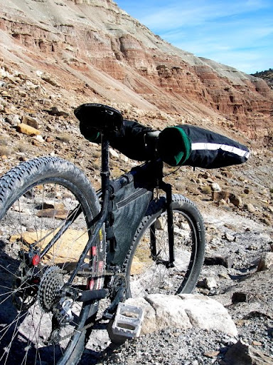

V3 for a friend (along with the other sewn goods)
He's ridden in them a -13F and stayed warm.
V2 testing.... a little warm with the sun out, but nice when the temps drop.  Somehow I've still gotten cold hands in them even at moderate winter temps....but V3 has a better bar closure than V2.  I might need to modify these.
